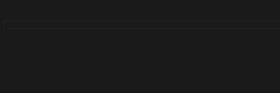

Paired with an editor like Visual Studio Code, the editor is smart about knowing what variable has which properties, while you are typing!
Intellisense

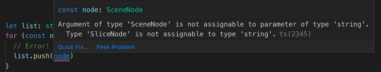

These type annotations are more than just comments with a new syntax. The TypeScript compiler can use them to detect accidental errors.
Detecting accidental errors with TypeScript
let list: string[] = []
for (const node of figma.currentPage.selection) {
// Error! Type SceneNode is not assignable to type 'string'
list.push(node)
Type error
Having the compiler tell you about errors generally allows you to develop faster. It's much easier to catch and fix errors when the compiler tells you exactly what line is wrong, whereas having to test the plugin to find bugs (or worse, having your users test the plugin) is much more expensive. TypeScript doesn't prevent all bugs from happening of course, but it does eliminate a large class of them.

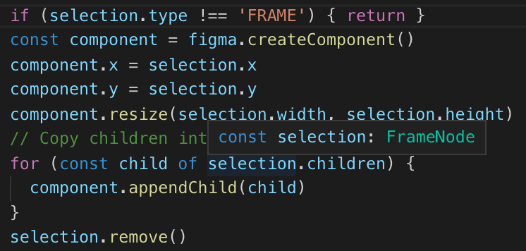

And the compiler is smart enough that, past that point, selection is always a FrameNode which always has a children property. It knows to narrow down SceneNode to FrameNode. Just hover over selection to see!
Node type on hover
