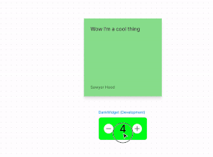

Making a Widget Stickable
If a widget is declared as a stickable it will attach itself to all other non stickables in the document. When your widget node is "stuck" to another node it will move along with the element it is attached to unless the stickable is dragged off of its stickable host.
In this example below you can see that the widget sticks to this sticky note when dragged over top of it.

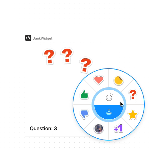

Below you can see an example of a widget that uses useStickableHost
. to count the number of attached stamps when a new stamp is stuck to it.
