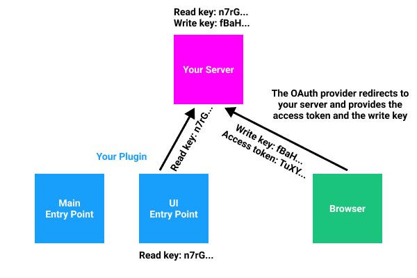

If the user isn’t already authenticated, from an API call made by your plugin iframe, your server generates a unique read/write key pair.
The read key allows you to read the value written by the write key. It will be used by the plugin to poll for the result of the OAuth flow. Each key is only usable once, which is why there are two different ones.
The write key allows you to write a value once to the server that can then be read by the read key. It will be used by the server to get the result back to the plugin after the user authenticates.
- The plugin iframe opens a new window hosted on your internet server using
window.open(url, '_blank')
and passes it the write key.
⚠️ Your OAuth provider should support the OAuth state
parameter. You must use that to pass along the write key. You must also store the write key in cookies on your internet server’s origin. Note that we cannot write cookies in the UI frame, because many browsers will treat such cookies as “third-party” and block them. These must be set during the top-level navigation. We also recommend adding an interstitial at this step for users to confirm that they intend to link their accounts.
- The user authenticates with the OAuth provider. This may involve the user logging into the service if they haven’t already logged in.
- The OAuth provider redirects back to your server. This redirects to the URL that you have pre-registered with your OAuth provider when you set up the integration, and should pass the
state
parameter back along.
⚠️ At this point, your server must verify that the write key stored in the state
parameter fed back to the server matches the value it stored in the user’s cookie. If it doesn’t match, your server should fail the request.
- Your server uses the write key to write the information you’ve received from the OAuth provider back to your server. This will not automatically re-focus the Figma desktop app. You should indicate to the user that authentication is complete and that they should switch back to the Figma desktop app.
⚠️ This write must be done over HTTPS, not HTTP. The access token is very sensitive data, because it grants access to the authorized resource.
- The plugin iframe polls your server using the read key.
⚠️ This must be done over HTTPS, not HTTP. The access token is very sensitive data because it grants access to the authorized resource. ⚠️ You must ensure that only this origin, which must be a real hostname under your control, can access this polling endpoint’s response, for instance by hosting them on the same origin or by correctly configuring CORS, or other plugins may be able to perform this flow masquerading as yours.
When the value has been written, the read will succeed.
