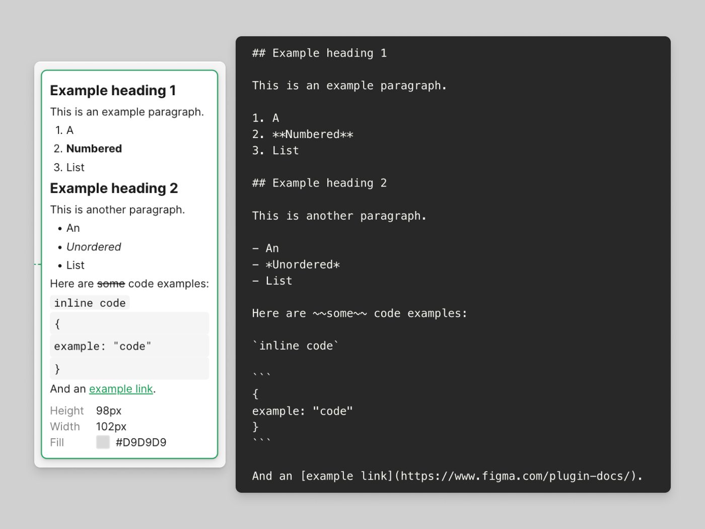

The following example shows an annotation in Dev Mode that uses rich text, and the corresponding Markdown.
Example of a markdown-formatted annotation in Dev Mode
