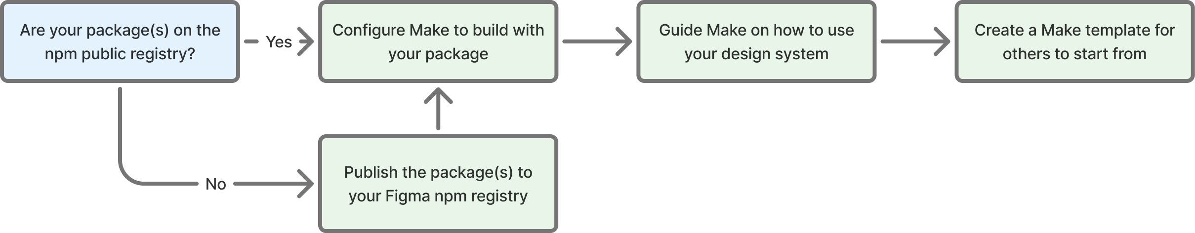

Follow these steps to publish and configure your package. Before you start, review the requirements.
  1. Publish your package
  2. Add your package to a Make kit
  3. Add guidelines to the Make kit

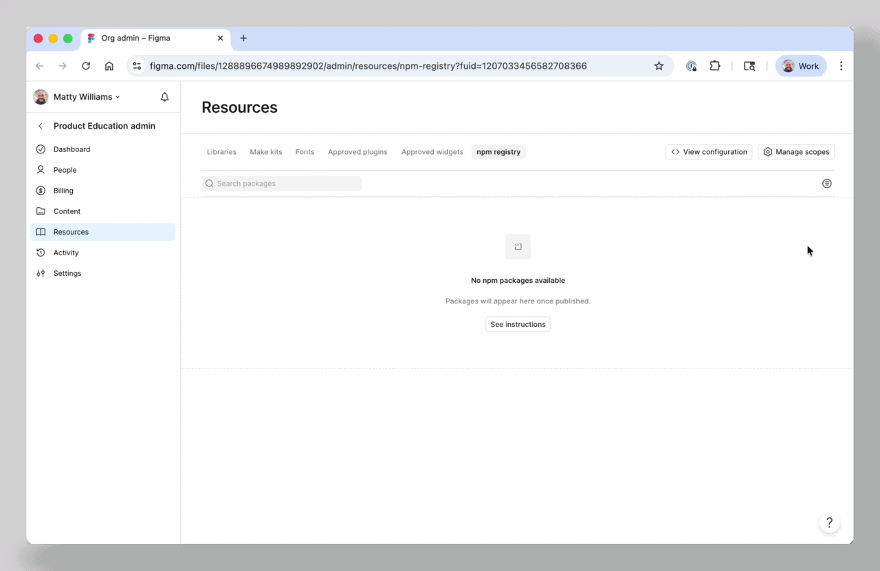

  1. In the file browser, click Admin in the sidebar.
  2. Click Resources.
  3. At the top of the Resources page, click npm registry.
  4. If you haven't yet, add one or more scopes for your packages:
    1. In the upper-right corner, click Manage scopes.
    2. Type a scope name. Ensure that the name is unique and doesn't conflict with any public scopes you currently use.
    3. Click Next.
  5. Copy the code snippet and paste it into your .npmrc file. The snippet won't be visible again.
  6. Run npm publish for each package.
When your packages are published, they're listed in the npm registry section of the Resources page that you accessed in step 3. You may need to refresh the page.
If you've previously added scopes and only want to obtain again the code snippet for your .npmrc file, click View configuration in the upper-right corner of the page you accessed in step 3.
