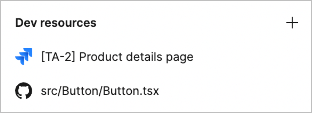

Dev Resources are a new feature of Dev Mode, which allow you to add links to any layer within Figma.
Image showing a dev resource
