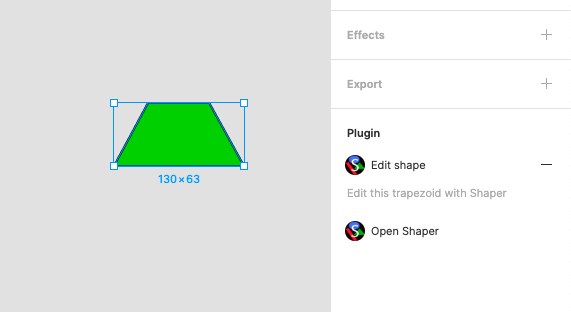

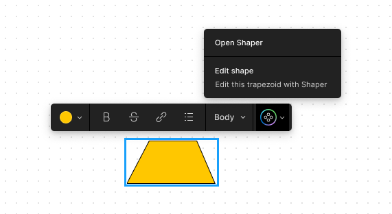

Examples
// With the following in the manifest:
"relaunchButtons": [
{"command": "edit", "name": "Edit shape"},
{"command": "open", "name": "Open Shaper", "multipleSelection": true}
// Add two buttons (ordered by the above array from the manifest):
// * an "Edit shape" button with a description of "Edit this trapezoid
// with Shaper" that runs the plugin with `figma.command === 'edit'`.
// * an "Open Shaper" button with no description that runs the plugin with
// `figma.command === 'open'`.
node.setRelaunchData({ edit: 'Edit this trapezoid with Shaper', open: '' })
{"command": "relaunch", "name": "Run again", "multipleSelection": true}
// Pass an empty description to show only a button
node.setRelaunchData({ relaunch: '' })
// Remove the button and description
node.setRelaunchData({})
Example Figma Design UI
Example FigJam UI
